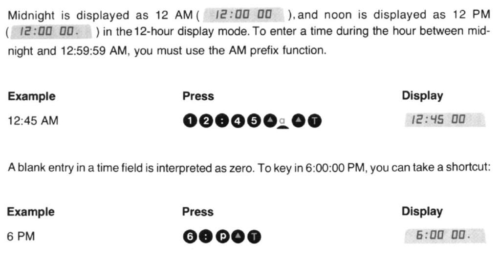

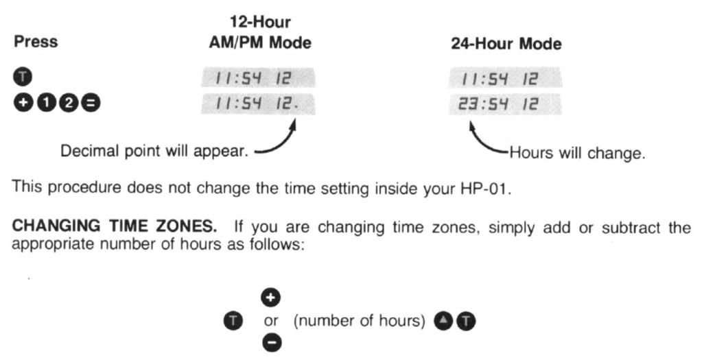

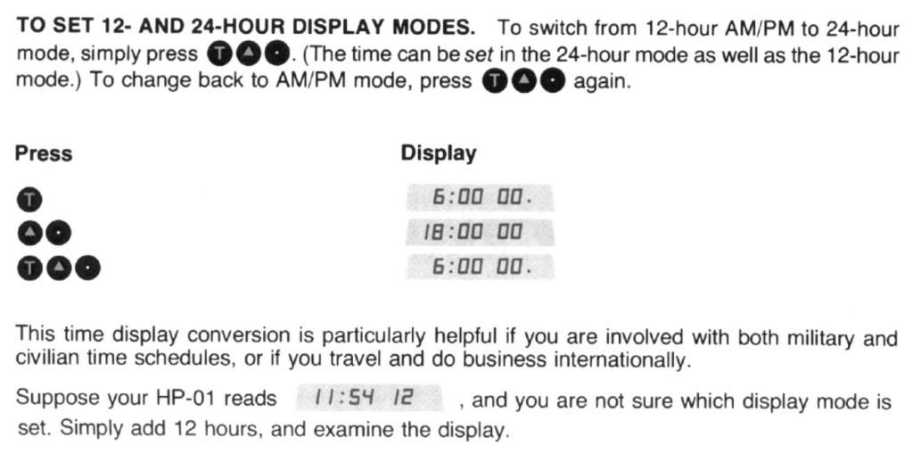

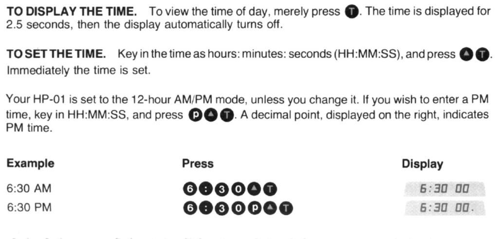

Here are some print screens for time setting.
Good Luck. :-)

Progress I have the time set ~:( because I have been playing with it I have lost the date, could you do me the screen grab for the date please.
