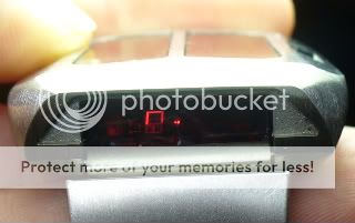

I found a top for you. It is not new but you can have it for free.
The display on your watch says it all: Do yourself a favour and do not waste any time with this module. It´s for sure beyond repair - no chance!

Thanks Hanno!
I have been weighing all options for module replacement, and I believe/hope you will be seeing my watch soon ;-)
I have already a new top on its way, so I will contact you about sending off the whole watch/parts here shortly.
