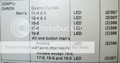

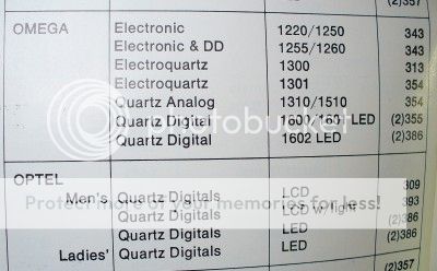

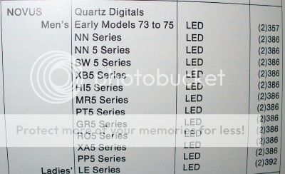

I found this 1976 battery guide from EVEREADY (UNION CARBIDE), and I think I actually found the Zodiac-Optel model number: 1970 , and of course battery size: 303 low-drain (or 357 works).
There are lots of other brands/models listed.
neat stuff
Crooked pics, but best I can offer without scanner ;-)
