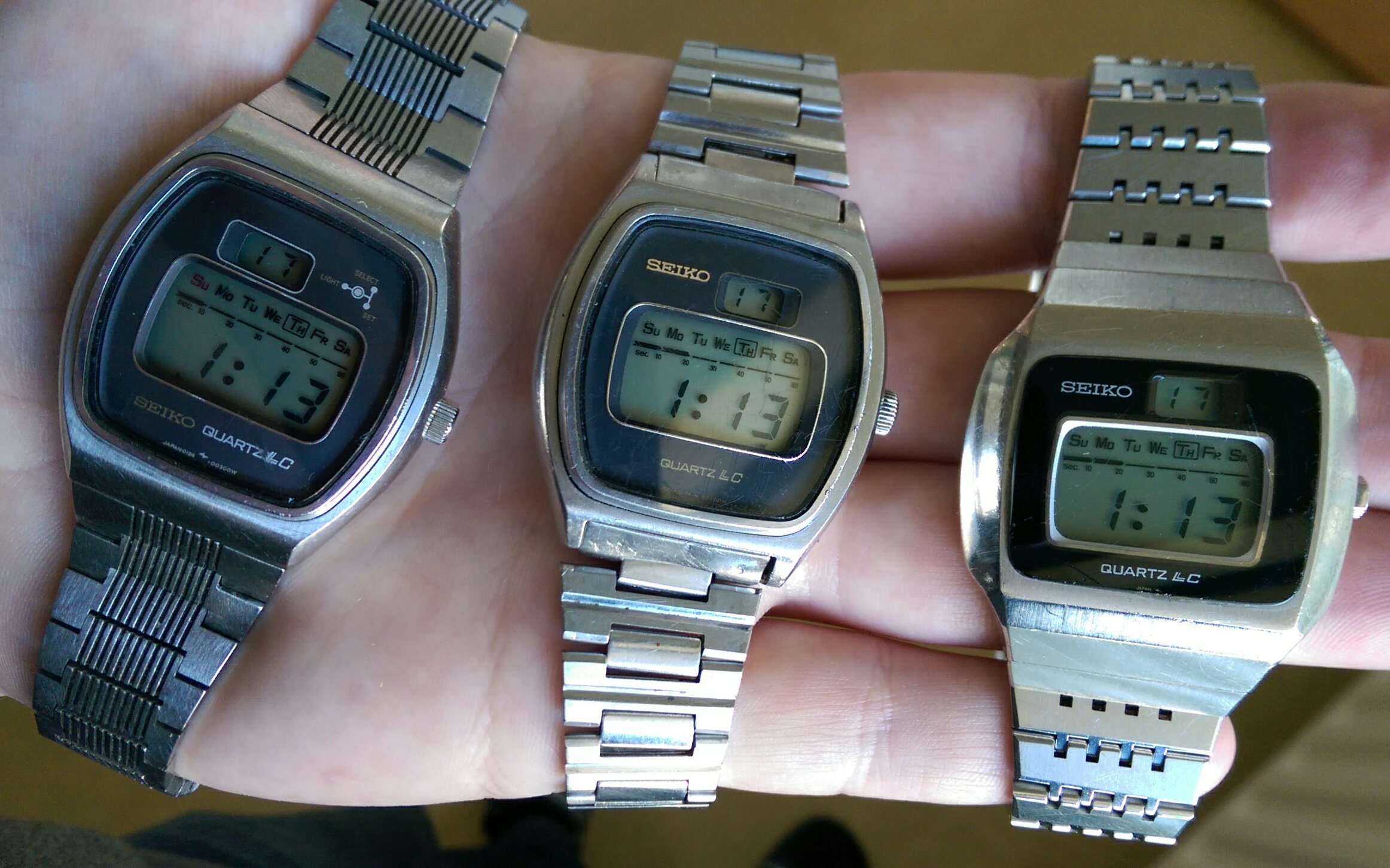

I've got three working 0124 watches now but some spare springs could be very handy :)
