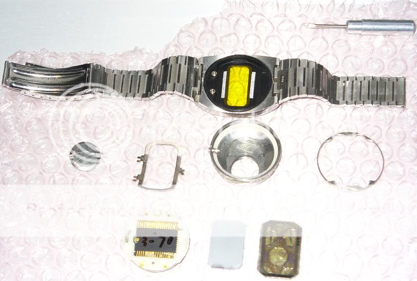

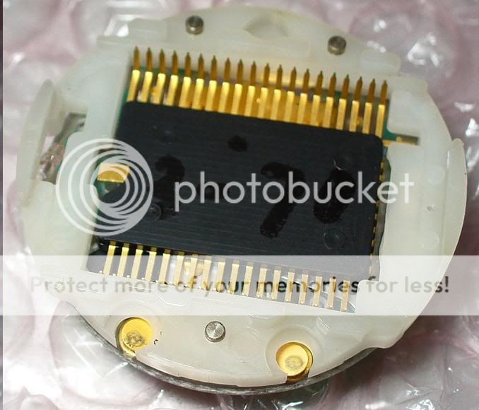

Does anyone have the IC prongs mapped out so I can pin-point to the one that operates the middle line segment of seconds read out? (far right digit...middle missing segment)
I can't seem to get it working, I don't see any damage.
If anyone has a working replacement bulb that would fit nicely...I am in need of one.
Thanks for any help with this.

Benrus you can download the technical guide from digitalwatchlibrary that has the info you need. I'm sure I have a bulb.

It is in the tech guide(page 21), but the prong you want is 1G the very last prong on the top if its the middle segment of the second zero you want.

Do take care working on this watch- this is one of two Seiko models that essentially have the main IC just lying on its back unattached (well, pretty much so) to any sort of PCB. This means there are no static dissipation pathways and that is an early MOS chip which is somewhat static sensitive (!). A watch where you should be properly earthed when working on it.
A dead segment can be a bad contact (look sideways at the chip in the carrier to make sure all the legs line up at the same height) or, especially if the watch has been left with a battery in for a long time, a bad output channel. Dead channels sometimes come back to life on their own if left for a couple of months or can be "persuaded" to start switching again by very slightly over-running the chip (you need a decent voltage/current limited power supply to do this safely).
