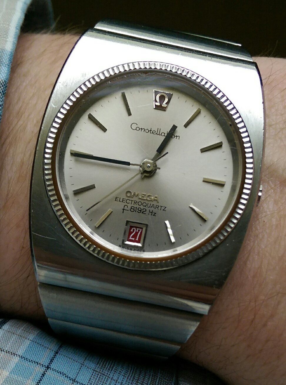

Before pictures
opening it up :-)
One barret (pin) of the bracelet was not coming out due to rust. So i had to saw it with a very fine blade.
first i tried to sand the glass but the clips are just to deep so after 2 evening of polishing, i just got rid
of it..i will make new glass.
small movie on sanding glass
https://goo.gl/photos/TvVo7xVbZR9NZRzu7
polished the case for one evening..still not satified..so it need one more evening.
then i decided to use my own special made antimirror glass instead of the original.
Broke 2 trying to use the original rim
the case still needed some work
I decided to use my own magic with the new glass and after a few evenings of sanding..the watch was finished.
Put new flexible transparent rubber glue between the 2 plates to keep it sealed...i not tested it for waterproof but i think she is:-)
now i will wear it forever..damn it's not mine.......you lucky bastard M:)W:)M
btw i left some dents on the case, some were just to deep and i had to take to much material away.
have fun all

That looks superb Kasper. I think it's fine that you left a few bumps and dings in the case - it's had a hard life and it's over 40 years old. Now it looks like it's growing old gracefully (and the lucky owner won't be afraid to wear it :-)
Did you make that new crystal yourself? If you did then :mega: :mega: :mega: :mega: :mega: :mega: nice work.
  • Posts: 2443
Re: Omega Constellation electroquartz F8129 restoration
Post29 Dec 2015, 21:00
yes...sourced the glass,...added 16 color layers on it in a factory and cut it myself.
It's not as hard as saffier glass but it's harder then organic glass and looks almost invisible at some angles.
