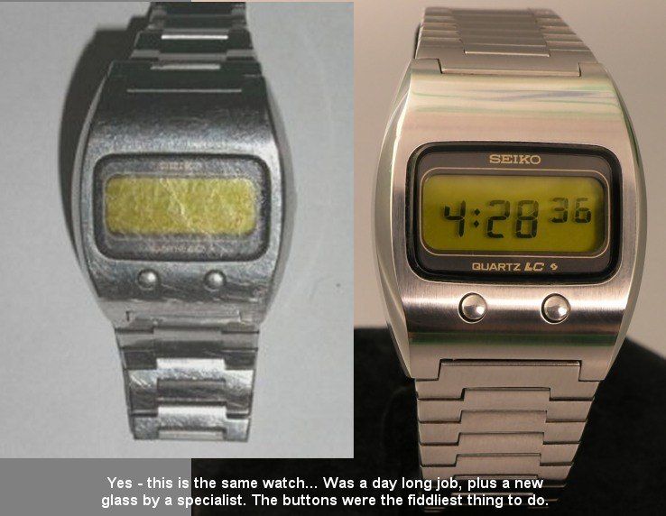

For the record, here is the original summary photo that I think you're referring too :-

@Arch ...indeed..that was the picture :-D , i was so impressed...i had to see if i could make it as clean as you did..mission accomplished :-D
I'm surprised that the watch is so light in weight.
The glass sitting in the watch was 1.3 mm thick, but i still don't know how to fit the new glass. I know it's cut with a little half corner on top...so it's bigger at the underside. I still have some broken pieces left :-D
But how is it fitted? Does it just lay on a silicon rim on the backplate so it stays in place and does not touch the backplate?
It's not sticking out like others so the top of the glass has to be cut so it the same height as the top of the case.
Not an easy one to cut but if i succeed (and i will) i make a few reserves for me and other members if needed.

Kasper wrote:@Arch ...indeed..that was the picture :-D , i was so impressed...i had to see if i could make it as clean as you did..mission accomplished :-D
it's not the same as with the 0624.
Kasper,
Getting in a crystal in a 0439 is a tricky one.
What i did, lay the glass in the case, then try to put the gasket around it, then put the bezel (called panel cover in the service manual) back in the case (goes in with some resistance so the crystal can't come out again)
Mind you , i had the original glass, which is kind of sloped on one side where it fits in the case, just like you probably said here " I know it's cut with a little half corner on top" , your new glass has to have that to, else it won't stay put in the case.
Look on page 8 in the service manual, it's not very clear as it's not an exploded view, but you might figure it out.
http://www.digitalwatchlibrary.com/imag ... /0439A.pdf
