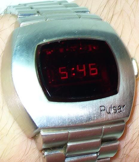

Well...I must say I didn't expect my module would ever come back from the dead, but it did!
It was like hot-swapping a hard drive (not hard, but tricky), and after much repeated effort, It Pulsates again :-D
I was afraid to remove it from my wrist (just in case it cools down, & stops working), But so far its been telling the correct time for over an hour! Only time will tell now if its fixed for good.
Thanks to everyone for the great suggestions, and helpful thoughts.
I had to warm it up repeatedly, place the batteries in, and place the back & ring quickly to get this working. I found by leaving it under the hot air flow of the fan from my TV projector (while on my home-made battery pack) that when the light finally grew dim enough to almost completely disappear, then placing a magnet near the command button...It finally showed signs of normal life.
Thanks again!

Post28 Aug 2009, 01:13
Well, The follow up...
Its like keeping a FORD running, Fix Or Repair Daily
Just when you think it's fixed, Its out again!
I am opting towards a Hanno SASM-14 replacement.
Thanks again for all your help everyone, and I wish better luck to those who are having the same issues as I am.
