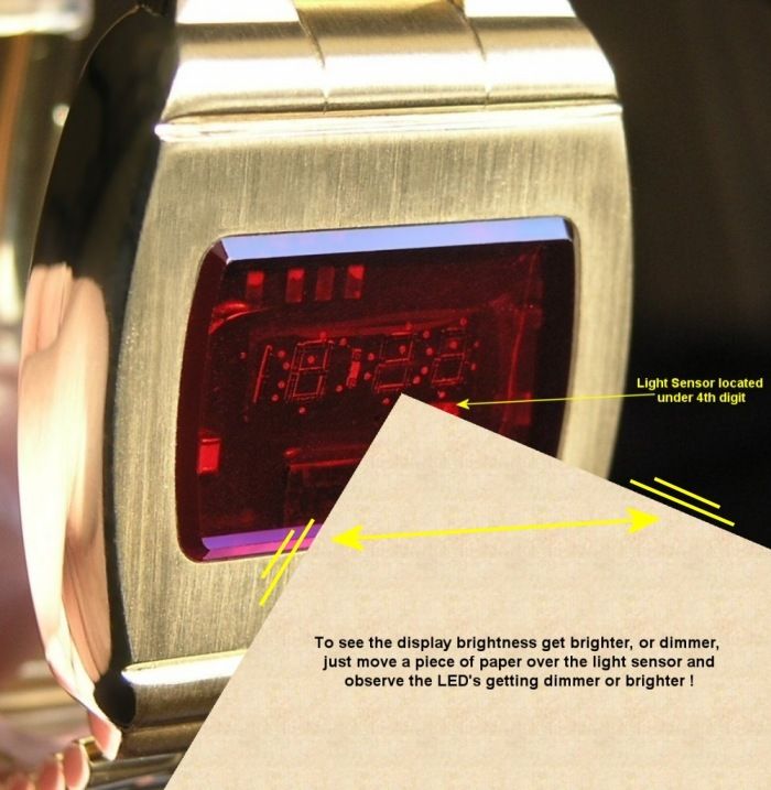

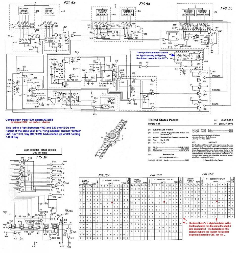

I’d like to offer some input on this old debate !
Basically, as far as I can tell from the E/D P1 schematic, the 25 chip module used 3 photo transistors to adjust the brightness, not LDR's. Their on/off function had the combined logical effect of adjusting the amount of LED on/off current to provide 4 stages of brightness, from 100% full on, to 87.5% on, to 75% on, to 50% half-on, made out of combined 256/128/64 hz 50:50 square wave pulses from the 32khz divider train. See the attached circuit for LS1, LS2, LS3 and associated NAND and NOR gates.
I've used an old photo below of a 25 chip module I used to own (non functional unfortunately) to highlight the three SMD phototransistors to the upper left of the hours digit, near enough to the display to be under the sapphire and detect useful amounts of ambient light.
Later P1 and P2 modules have a different brightness adjustment process using a single LDR - visible as a long skinny SMD resistor with a wiggly track on it to the right of the digits !
You can easily test the light sensing in action on later P1 and P2 modules simply by moving the edge of a credit card back and forth over the right hand side of the red lens - the brightness will appear to go up/down ! (see illustration below)
I studied the 1970 HWC patent a couple of years ago, and somehow spotted a minor mistake in the patent for the boolean decoding of the digit '4' into segments. If the segments for '4' would have lit up as originally filed, you'd get a segmented ' y ' not a '4'.

Interesting. Thanks Diginut. I really didn't think anyone would know for sure.
Those 3 black squares were one of the candidates we had in mind. So these photo-transistors operate logically/digitally as opposed to the LDR resistor used in the later modules. Do the LDRs used in the later/normal Pulsar modules produce discreet light levels (I've got in the back of my mind thet they do), or does the display brightness vary smoothly through it's range ?
BTW, nice work debugging their boolean code :lol:
