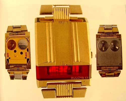

Post17 Mar 2007, 17:48
Very nice!
From the images I have (attached - I hope!) the B&W one seems to suggest a crocodile style strap. By the way, I have an 'N6' Accutron spaceview which by then was very 'old hat' indeed.Image
