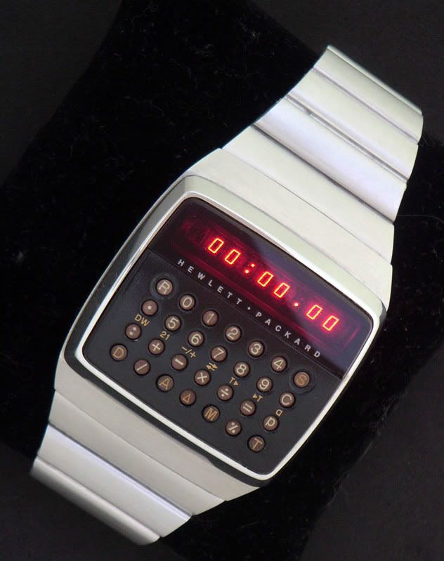

It has arrived, the ultimate nerd watch
For HP's first foray into the world of watches the quality just oozes from this watch. I will let other already published descriptions describe the watch in detail.
Suffice to say, Wow to the quality, fit and finish and the added details such as gold plated connections and circuitry. The keys are flawless as is the strap and case. The strap even has a quick release to allow for battery changes! Came with a soft pointed stylus attached to the strap buckle.
I CAN'T GET THIS off my wrist!!

I've seen loads of photos of these, but i'm still as impressed as ever. I'd say, for looks, its the best calculator watch ever made.

Good old HP-01. WOuld probably be my favorite watch if it weren't so heavy. Very good condition on that one, really amazing. Congratulations! :D

I have one of these in GF; same condition. If it wasn't for the fragility of the gold surface, I would certainly wear it, at least occasionally. A minor mark on stainless could be touched up, but the 20-micron plate on these just won't allow that luxury. Fantastically cool watch, nevertheless...

That’s a very nice watch/calc you‘ve got there well done, I see you have a HP LED calculator sitting next to your treasure I've noticed some of these old calculators can be a bit slow, if you divide 8 by 9 this shows up quite well the calculating power of its chip.
How does the HP-01 look compared to the calculator.

The calculator came out of a box as NOS, never used, still have the box, papers, manual and accessories all shrink wrapped and in perfect condition. I replaced the pinch roller in the calculator as these deteriorate due to age not use!
The watch is comparable with no hairline scratches and perfect crystal and keyboard. The electronics were stored after purchase without batteries and as such exhibit no corrosion or use or even swapped battery scratches on the contacts!

congrats, it's the best condition HP01 ever!
and you can polish a scratched crystal to 90% condition and still keep the logo if you cover it and polish milimeter by milimeter. an hour of work but it can be done. some experience is needed though so that the difference will not be that significant nor that visible between the polished and unpolished part.
