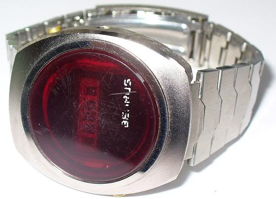

I recently bought this watch at an antique mall, and wanted to get batteries for it so I could use it as my everyday watch. The problem is, I don't know what size to get. The watch came without batteries installed (Which I thought was good...Clean compartment), But there is not any battery info anywhere on the case. If anyone has a good suggestion as to what size I should be looking for...

I am pretty sure the battery size you will need is 357 (LR44, AG13) or silver oxide size SR44, the other possibility would be 386 (LR43, AG12) or silver oxide size SR43.

Basically any 1.5V battery that fits will be ok.
So you can measure the battery compartment and decide according to the battery sizes given in the chart mentioned above.
Take the biggest battery that fits - the bigger it is the longer it will last.
For LED watches Silver Oxide is preferred over Alkaline, but rather hard to get in stores (and expensive there).
I'd try with a cheap-and-easy-to-get Alkaline and replace it with a Silver Oxide of same size when it's empty.

My vote is #357 for correct size...buy silver oxides.

BENRUS wrote:After seeing the 357 size battery today, I had concern about if it would be too large depth wise. If the battery is set in place and then screw backs tightened...Could there be a possibility of cracking the board?
Yes - if the batteries are too thick and you apply too much force. 386 are the next thinner size, try these first if you are concerned about thickness. if they don't rattle in the compartment, that is have contact, they will also work.

#357 did the trick ;-)

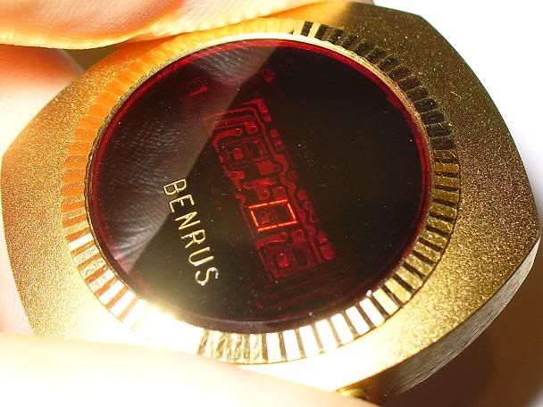

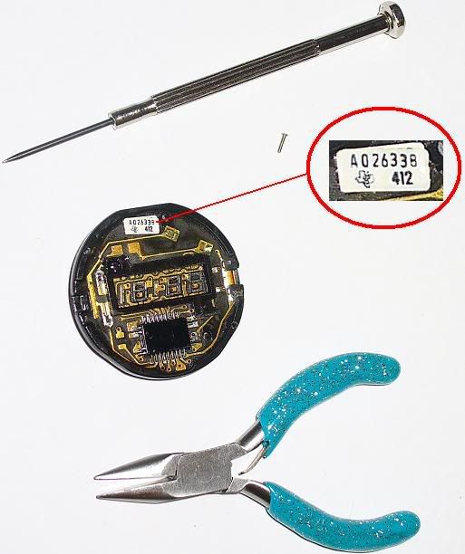

Does anyone know how to remove this module from its case? The module is stuck into the case very tightly. It only shows up a "0" in the next to last digit area when the twist dial for setting time is actually pressed in while lined up with the "H" for hour setting (If that makes any sense). I'm sure I will not have any luck myself in fixing this module, and am in the need of a replacement (I think), but I don't think I will get far with a swap if I can't remove the old.

Are the points arrowed screws... :?:
Usually if a module is showing a single digit it needs a new quartz crystal which is a nice easy job if you can use a fine point soldering iron... :-)

Klippie wrote:Are the points arrowed screws... :?:
YES...I thought those needed to be removed, but I couldn't find a micro screw driver small enough (I'll have to get one). Where can I buy new Quartz Crystals suitable for the job?

THANKS FOR THE IDEA!...I have since worn this logo off very quickly in the weeks worth of wearing the watch. I wish this watch had the inlay logo on the crystal like my gold one I have pictured.

Post07 May 2009, 21:39
Benrus:
Your second "Benrus" has a Texas Instrument's module - those ARE screws holding it in. But go back to the setting procedure - many TIs have a quirk in which they only show a "0" until set. And the setting screw has to be held in contact for a few seconds for it to start moving forward. Those are really cool modules, but the setting screw frequently is not in proper alignment with the internal contacts, due to slipping of the contacts on the screw shaft. :x That watch is the model that immediately followed the "Wells"(Benrus) 100. A very rare module.

retroleds wrote:That watch is the model that immediately followed the "Wells"(Benrus) 100. A very rare module.
Thanks for the response retroleds! Are you saying the "Wells" 100 is the very rare module, or the module that is in my Benrus? Either way, I thought this watch might be something when I found it on the Bay the other day, but was very disappointed that the person who packaged this watch decided to place packing tape right across the whole watch to hold it in its original case, therefor taking off the gold plating on the original watch band! (I think the chemical make-up of the sticky part of tape dissolved the coating somehow...Oh well, nobodies perfect! I got this watch for a steal anyways, so getting it to work without too much effort would really sweeten the deal. Thanks for telling me about the "0" thing, I'll have to try again with setting time.

I was able to remove the module with ease after removing the screws...LOL!
I lost the retainer clip that hold the stem in while trying to clean around it a bit :-( It doesn't do anything but display that "0" as pictured when I press the time set screw on the back in while lined up with the "H" position...It does nothing when the side button is pressed, and does nothing in the minute ("M") time set position at all (even when pressed in). I tried holding the setting buttons in for more than a few seconds with no success.
I don't know if there is much hope for me fixing this, I'm just leaving nice tool marks on the case, and loosing parts!
If you notice where the sticker is placed on the module, you can see that there is a sticker on top of a sticker, is this normal, or should I be tempted to remove the top sticker?
