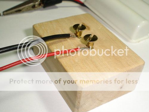

I built one recently out of a block of wood, brass flat-top wood screws, and wire. The 3v tester I made from a battery compartment holder that uses two AA batteries from a store display that had a blinking LED light.

ok i don't know nothing about electonics but for me....the first one looks world war II stuff and the last one Prehistoric. M:)W:)M but still better then mine...i don't have one.
damn i think about it...i have to build one myself 2 now :-D

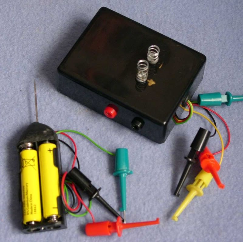

My two LED testers are somewhat different;-
Both have built in 32Khz oscillator chips for checking for oscillator failure. The small one with the two side by side AAA cells was specifically made for testing Nat Semi modules where there are clip on points for everything! The black box one is more general purpose and offers either clips or the two spring terminals for power connection. The red & black sockets on the side are for your multimeter (on a current range) to plug into and also serves as an on/off switch for the oscillator circuit (I use the SG-3030JF chip in the 32Khz version). Both have a centre tap for testing buttons (the green lead).
Re: An easy to build LED watch tester
Post01 Aug 2012, 13:17
It´s fun to see the different versions and ideas of your testers. And I am sure the 1€ wooden block with two screws works pretty well :)
Moreover I like the idea of the oscillator so much that I will add one.
