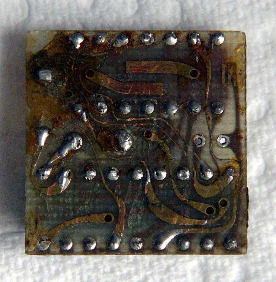

I think the biggest problem with producing a replacement module for a Sinclair will arise in trying to duplicate the cheap & nasty mechanical assembly methods used in the watch- the front and rear contacts for the setting/display buttons were etched onto a self adhesive wrap around flexible strip and getting this off intact is usually the biggest challenge in repairing a Black Watch. The actual electronic components were quite reliable- the circuit board was not, made from the cheapest Copper covered board imaginable and with no protective plating on the traces the glue from the wrap around strip would mix with a little water and dissolve the Copper off the board in no time especially when the watch was under power.

Typical backside yuk;-

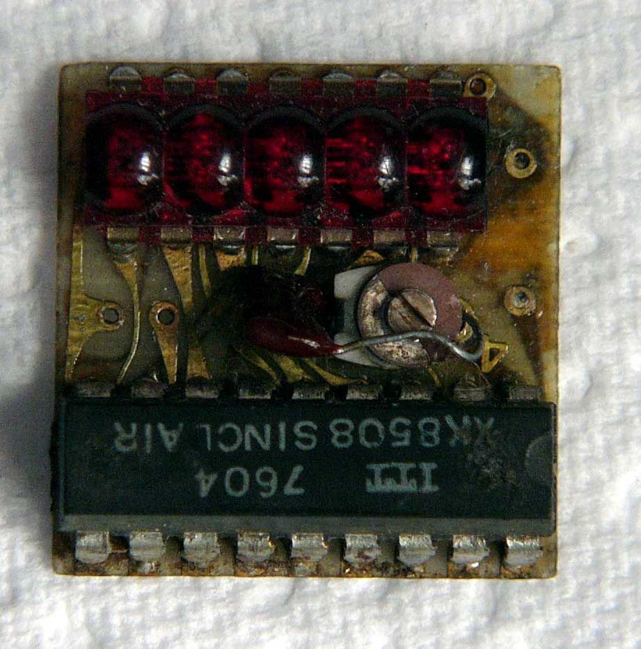

And about a third generation 1st type front view (missing crystal and a small ceramic capacitor upper right);-
As far as I know all the original BWs had the five digit Hewlett Packard displays in them
