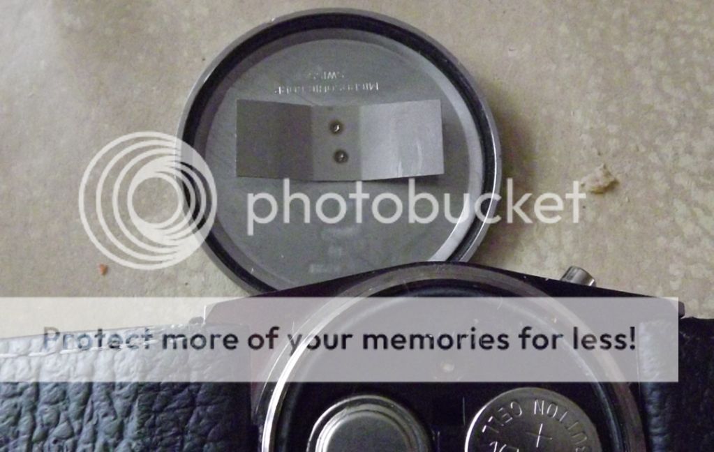

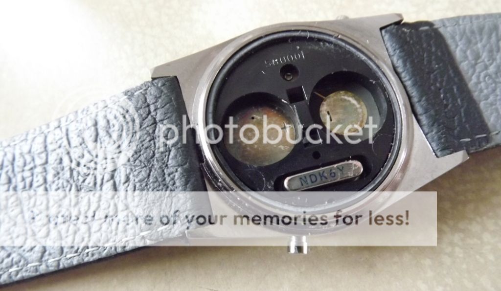

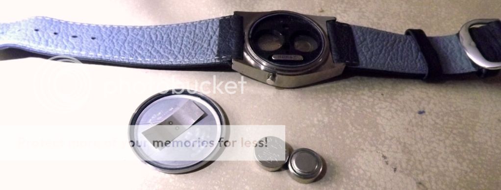

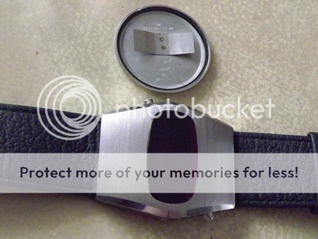

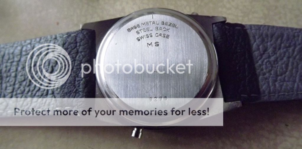

Popped the back off my watch but it won't pop back on
Tried a watch back press - no luck
Even my well respected local jeweller couldn't get it to go back on
Does anyone have any ideas please - pics enclosed to show the watch
Thanks
Paul

Slightly daft suggestion but are the batteries (assuming you changed them) the right size? Some of the
same diameter are different 'heights'. Too much force in this case will crack the module circuit board..

I did tey refitting without the batteries and then without the mocvement but no joy
I did pop the back off and it came off really easy
I will try the suggestion of making up a bespoke die as I share your fear of breaking the front too
